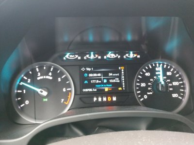

This is pic right after I hit ok, to make msg go away.

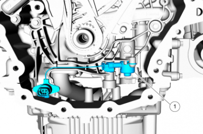

There is a pulse width controlled solenoid that controls oil pressure
Might have that checked

Here is the location of the oil pressure control solenoid
Doubt you have anything major going on
Possibly solenoid stuck open from small particle

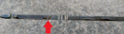

Where was the oil on the dipstick? Reading that thread you posted, seemed to indicate that the oil stick isn't accurate, you should be at least to the full line and maybe slightly over.

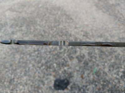

Sat all day, on level ground, I had a bit of a pitch where I normally park, so to be sure I moved it after I thought about it.
This is the stick.

Assuming this is your oil level
Then we've ruled that out :(
Looks pretty clean as well

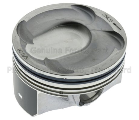

Thought all of you might this interesting
Here is a pic of a Ford ECOBOOST piston
Note that they use a forged piston with a steel ring land for the top compression ring just like those used in Diesels
The also use deep skirt blocks with cross bolted mains, forged crankshafts & forged connecting rods
Makes them pretty bullet proof

That's pretty stout stuff Mike. If it happens again be sure you snap plenty of pics from your phone, showing the dash low oil pressure, along with pics of dipstick level. When it comes to dealers you've got to prove your case. You might want to do an oil pressure test yourself, or maybe pay a shop. Just again for ammo, in case you have problems down the road. As far as oil filter, you might want to try a top filter besides Ford, if in fact their having breakdown of paper in filter. Ford racing filters, along with Mobil 1, and Royal purple are the 3 top ones out there. Not cheap, but do work well.

I'd say the oil level is actually a bit right of the center of arrow.

have you looked to if see you might have accidentally loosened the connector for the oil pressure solenoid when you installed the CAC?
It is to the right of the harmonic balancer (passenger side)
How about the EOP sensor connector directly above the oil filter?
