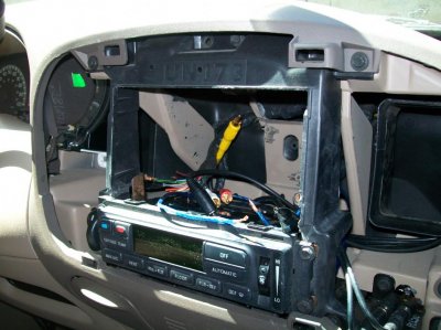

small saw, this is what the dash looks like right now after makin it fit
it fits snug in there and dont need a cage or dash kit
im gonna make a fiberglassed casing for the front peice since i dont like how carpet materials look on the dash.

cool thanks for posting the pics....i noticed that you didnt have to cut the top....i was looking at other pics people posted up here and they cut about 1/4 of an inch off the top piece....guess when i get back from this deployment i will have to see which way to do it.....but i now know what definately needs to be cut.....that bar in the back and the piece between the ac control and radio...thanks again for the postings.
