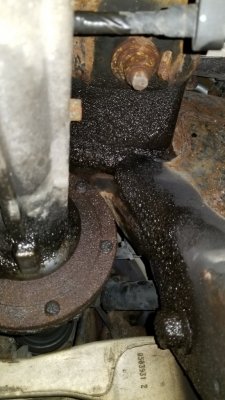

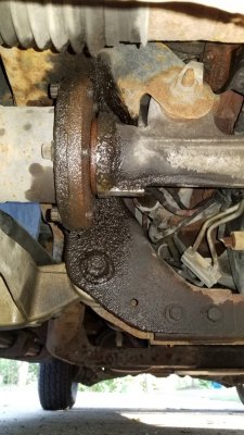

Looks pretty straight forward, but I can't find the first bit of info on YouTube regarding changing this seal, or the drivers side.
Anyone have any photos or how to videos?

A repair manual would be of help. You could also watch vids of other trucks to give you an idea. Good luck!

I have been looking at this on my 05 as well. May want to check the bearings inside the housing. I can grab where the axle at that end and move it a bunch. I have read some other posts about rebuilding the whole center section due to the bearings going out.
Just a thought.
