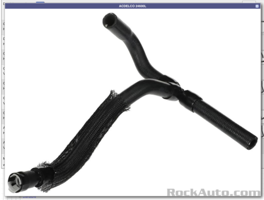

@KimberlyH, you have been given some good advice from @whtbronco and @acampinoob. Since you said you changed the heater control valve that shouldn’t be the suspect. And if it was you would see it leaking every time you run the engine, hot or cold. That component doesn’t leak from the vacuum line itself, but from the valve actuated by the vacuum line.
Check this hose that comes off the coolant cross over and heads towards the heater core. One of the line sections goes down the side of the engine towards the wheel well. This is an obstructed hose in the general area of concern.
There are also drain plugs in the engine block on the driver and passenger sides. This is how you would drain coolant from the block directly if you needed to empty it as much as possible without removing and rotating the engine. You’ll see a small 7mm hex below one of the freeze plugs. It was installed with some thread locker and ‘shouldn’t’ leak, but if the block is cold enough it’s possible, and as the block warms it expands. If you find this plug is loose, you can use some plumbers tape and reinstall the plug to prevent further leaks.
A lot of the hoses are on top and if you are loosing a lot of fluid you should be able to see it from one of these hoses. The temp change being a sign points to a seal failure for sure. You just have to take time to hunt down the various seals. This is probably one of the least enjoyable things about these engines is all the different hoses to check. You have to choose a direction, but working outside in might be best. Firewall near the heater core in the rear, intake manifold in the front, and hose to auxiliary heating unit in the rear. Then work towards the ‘middle’ from each of these points.
