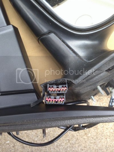

3. Unplug old mirror and compare new connector and old connector. We matched!
4. Plug new mirror in and check for proper operation. GOOD!

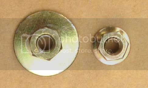

7. Remove new nuts from new mirror. The flange washer on the new nuts was much smaller than on the old ones, so I reused the old nuts.
Old nut on left.

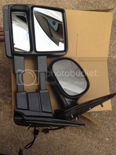

Side by side comparison

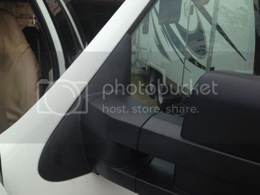

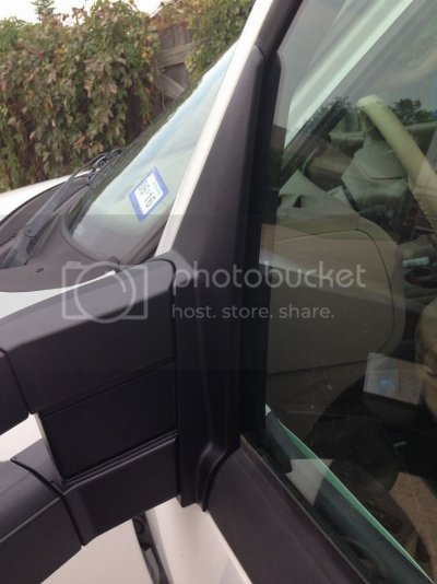

After install comparison

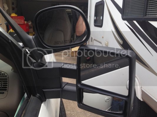

Extended comparison

If you are 5' 7" tall or less - DO NOT install these mirrors! They will create huge blind spots for you. Darlin is 5' 8" and she made me look from her perspective. 5' 8" is ok, i'm not sure 5' 7-1/2" would be.
The mirrors are BIG! - look at the pics. You CAN NOT see THROUGH the mirror and it's housings. If you tow a utility trailer, you don't need these, you can see OVER the trailer.

My top right mirror is not "zoomed in". The bottom mirror is "zoomed out" substantially (and may be closer to what you are accustomed to with the stock right mirror). Look at the reflected images in this pic to compare.
Compare the door handle size in the spot mirror with the top mirror and notice the difference in the size of the passenger seat in the stock mirror and the new top mirror.
Your old mirror has been lying to you for so long that your brain has compensated for it and now the truth looks like a lie.
