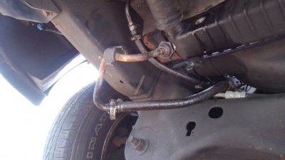

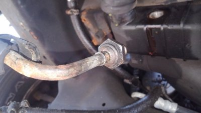

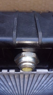

I posted what is under my truck at the moment, I can't seem to separate the fitting from the tube part. What is on the new radiator is the fitting with no tube. Yet I tried two types of "tools" to separate the fitting from the tube but the design is all wrong. I tried slipping in thin flashing to separate and this is a no go. The distance between the tube and the fitting is too close to work with. I'm used to working with a flared of the tube and a SAE threaded fitting. Is my only option to try and thread in the old fittings to the new radiator? The past person really hated the tube that existed and tried to replace it with hose. The fittings inside the old radiator seems to be loose (can move in but not rotate), if I replace the new fittings will I have a leak point?

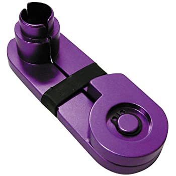

Thank you for the wrench information. I tried thin (less than 0.020") flashing to see if something would get pass the fitting, it wasn't working either.
Plan on removing the oil filter and while the radiator is out see if I can reach the suction hose since I bought that (thinking the old hose way be collapsing) and the hose is attached with a worm drive clamp. I have spares of those. The main feed from the over flow tank looks fun, I guess the power steering pump needs to be out of the way as well. Didn't buy that one although that hose is only pressurized.
The threads match from old to new on the fittings. I'm not sure I like unbolting fittings on the new radiator but at least getting the truck's engine back running will tell if the head gasket is the real bad guy or did I fix things for awhile.

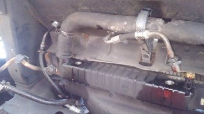

OK, I manage to change the suction hose while the radiator was out. I can see that this is the only way you can reach this hose is when the radiator is being changed. The side radiator holders did not want to come out attached without banging into the air conditioner tubing. I unfasten them first and removed the old radiator without them. On the return trip I attached the passenger side and placed the driver's side holder in place and eased the new radiator in. While juggling with the holders I almost forgot the shroud. With enough working parts back and forth it went together. Getting the little square nuts in the top of the radiator to co-operate was some work. Now to the bottom. I removed the transmission cooler fittings starting with the long tubing on the passenger side. Sprayed oil on the line until the old fitting on the truck spun around reasonably well then covered the threads in blue (removable) thread locker (to help seal). Did the same with the driver side connection then attached the supply hose. The rest of the stuff went together normally. Filled the over flow tank with two gallons of concentrate anti freeze and two and a half gallons of water. Fired it up with the cap off, got some air burping out as it slowly warmed up (still had the thermostat missing). ECT from the code reader went to 130 deg. F and I shut it off while putting tools away. Put the cap back on and drove it around, took awhile (12 minutes) for the dash gauge to move in the center. Pulled over and checked for leaks, none found. Continued to drive for a total of 35 minute mostly stop and start traffic. Dash gauge stayed centered. Code reader's ECT measured between 210 and 220 deg. Not sure if this is normal but it was pushing 240 to 250 degrees when over heating. Still will run some short trips before fully trusting it again. At that time I'll replace the open thermostat with the new 180 thermostat. Note: I checked the oil again for signs of water or anti freeze. Nice amber color that I could read the MIN letters though. Was bracing for brownish oil from a leaky head gasket. I hope I dodged the head gasket project for now. If someone can confirm the ECT temperature was normal or not (210 to 220 deg F) from the code reader that will help.
