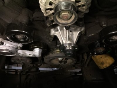

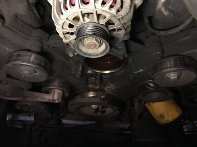

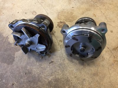

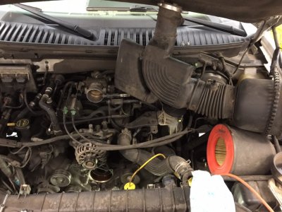

Got the water pump and all the idlers replaced today. Pretty straight forward. The hardest part was getting the fan off of the water pump pully. I had watched a good Youtube video on how to replace the water pump and they mentioned a special tool. Went to O, O, O, O'Rileys and borrowed one. Bought some anti-freeze from them while I was at it... figured I'd give them some business since they let me borrow some tools.
I enjoy working on the car but there are two things I hate...
  1. My shop light ALWAYS, no matter how I position it, ALWAYS ends up shining in my face!
  2. Even though I have a box of rubber gloves to keep my hands clean while working on the car, I ALWAYS forget to put them on before starting to dig into things. By the time I remember, my hands are filthy... actually it's the filthy hands that reminds me I have gloves.

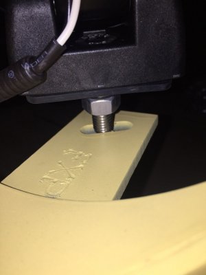

Oh, I tried drilling out the mounting holes for the lights on my bumper. Ended up breaking my drill. Not the bit, but the entire drill. The slot was probably 10mm and I was trying to open it up to a 1/2inch (12.7mm). The bit caught, regardless of how slowly I was trying to approach it. After several of these bites and instantaneous stops, the drill started making weird noises and then just stopped driving the chuck. Decided I'd let the HNC Customs guys deal with it come Thursday... can't wait to get the bumper on!!
You probably would have been better off grinding with stone or a rotary file instead of trying to drill it. Smart move to let them do it. Of course now you have a good reason to get a new drill :D
Thanks, Andy! I never would have thought of the grinding approach but would definitely have been smarter. Next time :).

Also discovered a step drill which could be used to open up the existing slot. Got one to try out.
