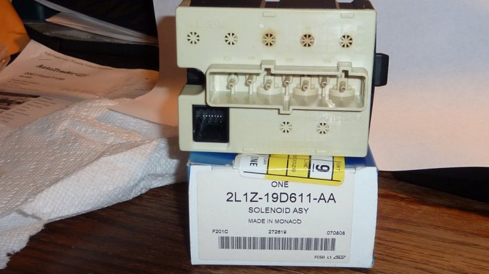

The vacuum solenoid control module is at the bottom center of the dash. You have to pull the center console out to access it, but don't have to pull the dash.
Zip Tie-ing the hot water valve closed won't affect the engine cooling, but it will help cool the cabin off by cutting off the hot water to the heater core. Hot water will still flow to the rear heater core unabated because there's no valve for the rear hoses. Rear temp is just controlled by the rear temperature blend door.
HVAC Vacuum Control Solenoid .....

The vacuum solenoid control......
Thank you very much. Now I understand more about heating system. I have still cold air in rear but hear all time some knocking ( flap stuck probably ) I'll be back after checking few things.
