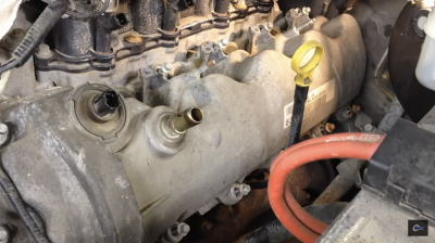

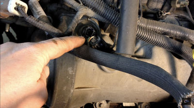

C109347A-08A8-412B-A34C-A50628D165BB.png A766644F-B525-48AB-9F19-960CF40B7CE4.png Hey there. I had the same issue and a handful of mechanics said the same thing as seen here.. HOWEVER.... You may be in luck..
There is evidently a very common problem with these engines..
If your symptoms are:
*When engine is hot, and only at idle you get a sound which is similar to the engine running on only a few cylinders... almost sounds like it is about to stall...
(Your sound was exactly like mine)
The problem is very likely VCT solenoids.
Variable Camshaft Timing Solenoid
There are 2 of them.. one on each side.
They are located under the valve covers..
Hopefully you are handy.. I’ll tell you why.
These CAN be changed more easily on the older engines. I believe in 2009-2010, that is when Ford redesigned the valve cover so it CANNOT be done without removal of the valve covers.
The Fu@kers made it so we have to spend $1000s in Labor to fix this but the older engines were easy.
Believe it or not, the dealer wanted over $2,000 USD to change mine. Fortunately I went to school for auto mechanics so I did it myself. You know how much the solenoid cost?? $60-$75 easy depending on where you get then aftermarket. (I used Advanced Auto Parts)
Your 2005 can very likely be done without removing the valve covers.
There is a round metal/rubber grommet on either side’s valve cover.. closer toward the front of the vehicle. You will see there is a wired connector which plugs into this grommet. That is the solenoid.. it’s actually shaped similar to a BBQ lighter and goes through the valve cover and bolts into the head.. there is 1 Torx bolt which holds that solenoid into the head.
All I will say is BE CAREFUL NOT TO DROP THAT SCREW WHEN TRYING TO REMOVE THAT SOLENOID.. Because if it falls, it’s likely to fall into the timing chain casing and that will be very expensive to retrieve..
There are COUNTLESS videos on YouTube about this issue.
Surprise surprise this has been a problem with the Ford 4.6/5.4L modular engines for over a decade.. and from what I hear THEY ALL FAIL AT SOME POINT. most of them prematurely. Especially if you often change your oil later than you should.
Anyway go find a guy on YouTube whose channel is “Ford TechMakuloko”
He’s a former ford tech and he really knows his sh... He has a video posted where he does remove the covers however I have seen other guys show it done without removal... but only on older models..
Here is a link to his video. He’s awesome. Be sure to subscribe to him and watch his others.
Good luck and I hope it helps.
PS.. He also has a link for the solenoids to buy on Amazon.
