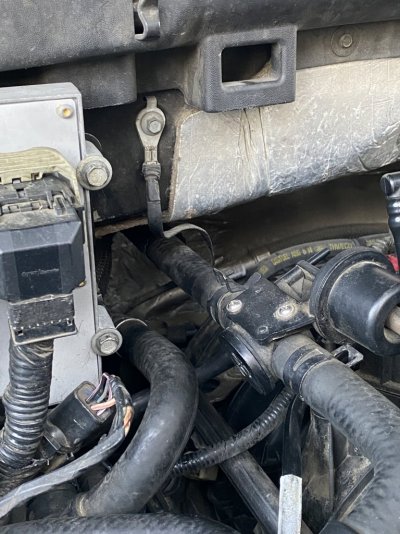

My mom's 2006 EB Expedition is leaking water onto the engine from the bolt holes in the firewall. The main places I can see water coming out of is the unpopulated bolt holes and the ground wires that have that hook on them. The leak is causing a flashing CEL and is throwing codes for cylinders 3,4,7. We replaced the old cracked cowl and seals but the issue persists. The area under the cowl looks clean with the exception of pooling water on the driver side that is about 1/2". We ran water over the windshield and the cowl doesn't overflow from what we can see but still runs out of the holes. Happens every time it rains. I am stumped and frustrated so any help is appreciated.
Photos of the holes / water intrusion areas may help.
