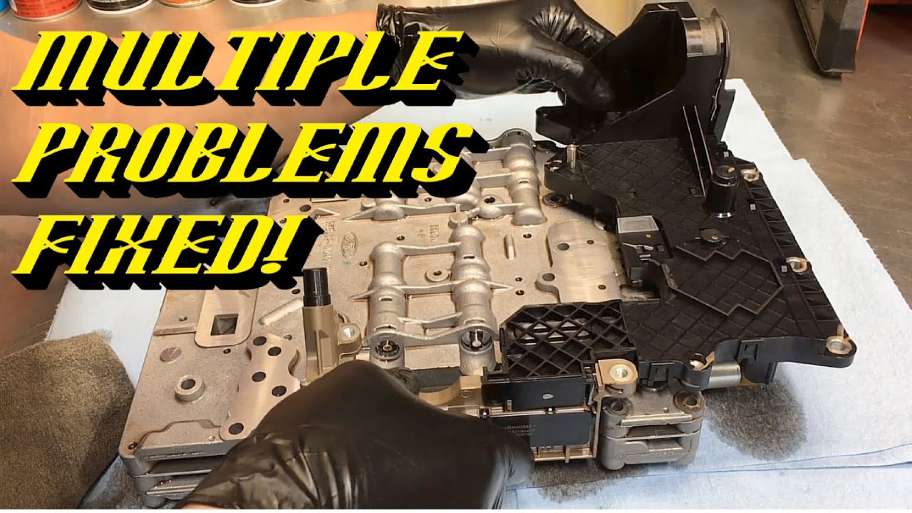

If your new pan increases capacity then you will need to add more oil. I have found that I did not need the special tool to release the wiring connector. Channel locks worked fine. The lead frame is a good idea, and I love that someone makes a dipstick and fill tube for this transmission now. We had a funnel and hose setup at our shop. We found that when replacing the lead frame, it took 9 quarts with the stock pan. We had a fleet of F150s with this transmission.

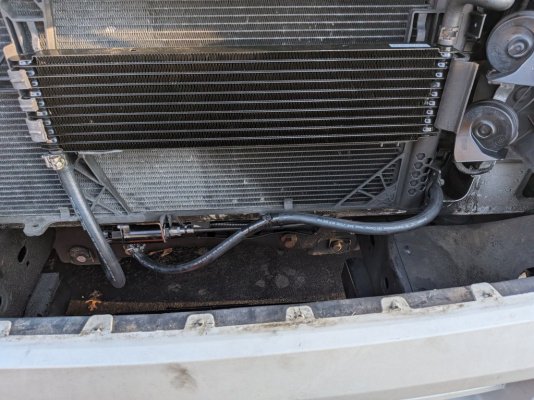

I believe the stock capacity is 13 to 14 quarts.
Cooler and filter add 1-2 quarts.
Deep pan adds 4 quarts.
I have 18 quarts. Should be good.

While the pan is off replace the bulkhead connector to avoid leaks in the future.
While your cooler is disconnected, replace the hose sections forward of the hard lines. Metal fatigue has caused enough of them to fail that it's worth the preventative step of cutting off the complex factory assemblies and replacing them with simple quality 1/2" transmission cooler hoses.
Cut-off wheel and a screwdriver make quick work of the failure-prone factory crimps.
