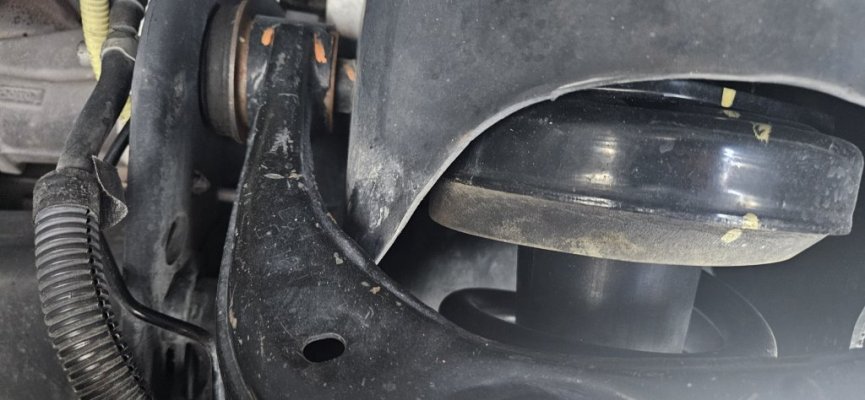

Hi all

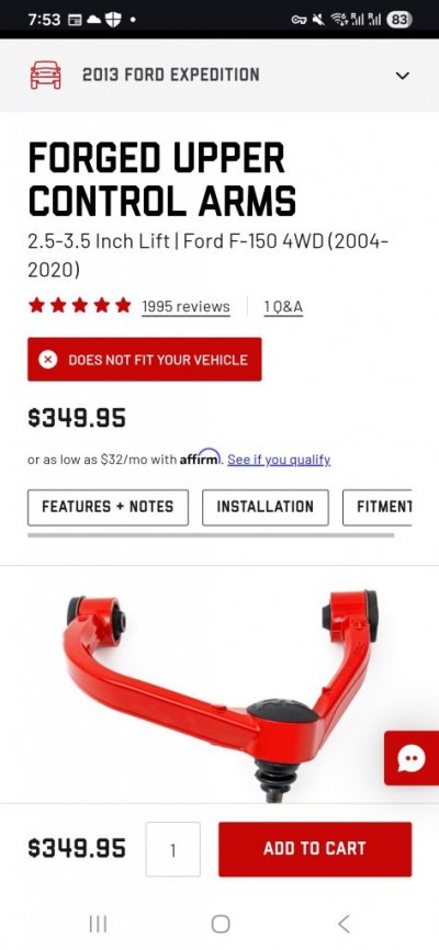

I lifted my 2013 expedition with 3inch front Readylift and 2 inches at the back. The UCA touches the spring when the car is in the air which is not good situation for offroading. I plan to replace stock UCA with Rough country ones...has anyone had any experience similar to mine. The product info says fits for F150 and doesn't say anything about expedition which i don't like. Thank

I will be watching this tread and look forward to what you find out. I have the same Readylift kit and while I don't know about the control arm touching the spring, I can tell you that despite religiously lubricating every 5K, I continue to have to replace UCAs because the ball joints wear out every 2 years. I have absolutely no proof, but my theory is that the change in geometry due to the 3" lift is causing the issue, despite Readylift swearing that it is not a problem.

AbuRakan - May I ask -- Did you purchase these control arms, and did they work on your Expedition? I just left me mechanic and he let me know that my left ball joint is failing AGAIN. I'm really looking for a solution!! -Thanks!

Rock Auto lists F150 and Expedition taking the same upper control arms
