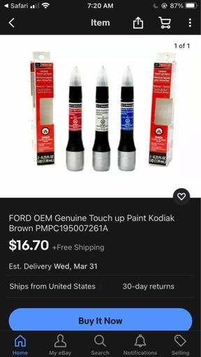

You can still get touch up paint. This is what you’re looking for. b768d45d19ca7e4ab7ea86cfd5c8fcbf.jpg

Thanks but my area is too large for those. I'll get a pint and spray it then clear after I sand and prep the inside and out.
