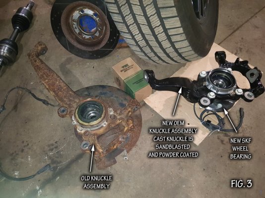

In this entry I have the heavily rusted cast knuckle that was not painted from the factory. As I was performing scheduled maintenance on the front end, I became disgusted with the rotting cast parts. So my choice was to replace them with new. When the new knuckles came they too were unpainted and already showing a light scale of rust. From there I sand blasted the OEM knuckles and had them powder coated black. Powder coat is expensive and I don't recommend that for everyone since there are many much simpler coatings that can be applied and you would get near the same protection. When all was done the powder coated knuckles were very clean and held up extremely well.
Since I was going in to the front end I went all out and replaced just about everything. The wheel bearings are a critical item so I used what I felt was the best bearing (SKF) considering the Swedish mentality for quality control and metals they specify. SKF makes great bearings but the Timken bearings that Ford uses are nearly as good, don't settle for anything less. Just about all of the parts used in this project that did not have to be OEM were a higher grade aftermarket. All fasteners are OEM and were expensive when you add it up. My thought is always "Do it right and do it once" and to validate that I never had an issue after this project was complete.

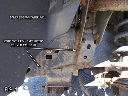

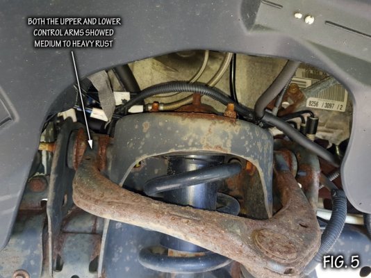

Rust happens, so I did my best to find it and slow it down.

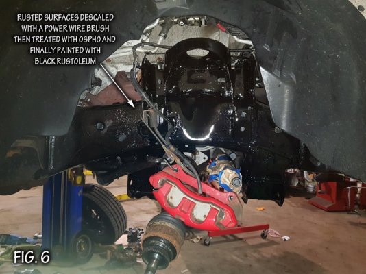

With all of the suspension parts removed it was easier to get to all of the rusted areas.
Rust scale was removed with a power rotary wire brush and the surface then treated with Ospho™ rust converter, and then coated with black Rustoleum™. There is a lot of talk about other paints and epoxies but overall a good enamel on the frame is the most practical. When all of the work is done there will be a coat of FluidFilm™ on the entire assembly.
