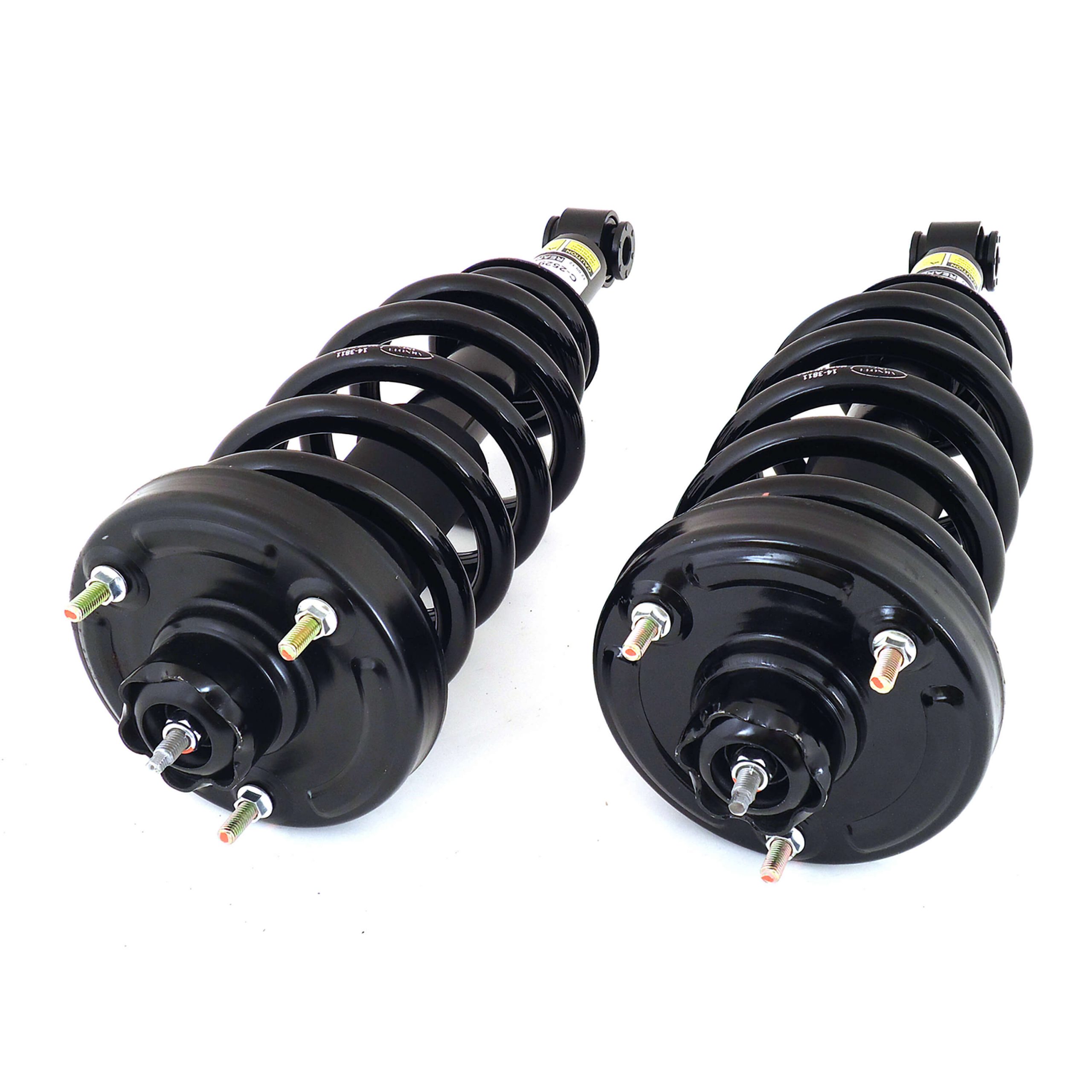

Thanks for that thread. Looks like my vehicle would use the following:
https://www.partsgeek.com/catalog/2...air_spring_to_coil_spring_conversion_kit.html
Unity Air Spring to Coil Spring Conversion Kit - Rear
Part Number: 118605-07724569
Brand: Unity
Notes: Air Spring to Coil Spring Conversion Kit -- Kit Includes (2) Complete Strut Assemblies Converting Air/Electronic to Standard Suspension; Excludes Extended Length Models
Product Remark: Excludes EL and L Models
  • Low Cost Alternative To Air Suspension
  • No Sacrifice Of Ride Height Or Quality
  • Reduce Vehicle Down Time
Position: Rear
Condition: New
Position: Rear
Package Contents: (2) Rear (Driver and Passenger Side) Complete Strut Assemblies - Instructions
Shipping Options: Free Ground Shipping
Ford Frank
Dec 27, 2014
23
Oregon
One thing nice about the Arnott is:
“Each kit includes Arnott’s unique, engineered Electronic Bypass Module, which seamlessly eliminates dashboard fault codes for a clean installation.”

I see that kit and thanks for the additional option. First thing I notice is that it is considerably more from a price standpoint (Over $300 more). Is the Arnott kit that much better or is the bypass module worth $300?
