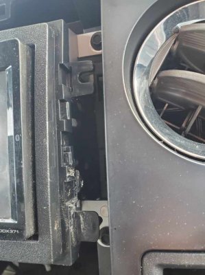

I have upgraded my Expedition Radio to a Double Din Kenwood. There is no kits available but thru research have found that the 2014 F150 Radio Dash mount kit works with very little modifications and unbolting the factory metal brackets on the factory radio. you will have to drill out the dimples in the factor brackets and next size up on the bolt holes to allow for the screws to attach to aftermarket radio. I used a Kenwood and found the two holes match up perfectly. for the wiring harness you will need the CAN harness (more expensive harness mine was 79.00)(years 07 - 17). Hope this helps you out in order to put in a aftermarket radio in your 2016-2017 ford expedition with a base radio.

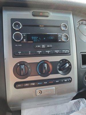

Im so confused by your truck. My XLT base stereo looks nothing like yours before the install. What about you're rear AC controls and all the other buttons? Also why does your truck have the round fog lamps? Am I missing something?

Mine is a Base model XL SSV. Originally mine didn't come with a center counsel or 3rd row seating. It does now have a Center counsel but none of the electronics work in it.
