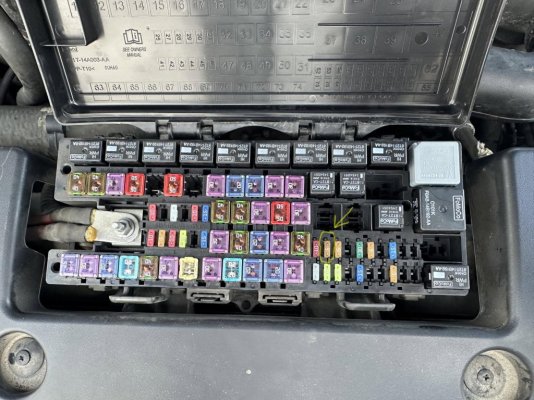

My engine shut off while driving with my 2015. I pulled on the side, and I got the same symptom as you described. the starter button clicked, the dash went on as usual, but no crank. I had my car towed and check calmly what would have caused the issue. Well, there is a 5A fuse which protects the PCM. (see pic below)
As I had major work done on the car (replacing camshaft, oil pump etc), i had to disconnect and reconnect the battery. I never found WHY the damn fuse blew, but I made sure all the battery connectors were tightened properly... I have been driving with the fear it would happen again, but so far nothing after 4K miles...
this is a 1 minute check and worth making you aware of (it cost me one fuse and one tow truck). since then I have a few spare mini fuses in my glove box. :)
Good luck!
