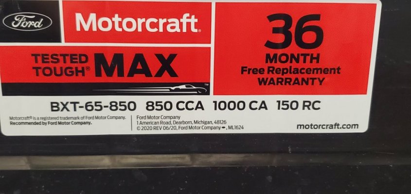

Battery. You can try cleaning the terminals and then jumping it. But probably better off just buying a replacement. Change it out and clean the terminals in the process. Batteries have become a maintenance item these days, I've changed 3 in both my 2011 and 2017 Expys, one of the batteries in the 2017 only lasted 18 months (which was replaced for free with Motorcraft 3 year free replacement warranty). I upgraded from 750 to 850 CCA. Here is what I have on both of mine now.
