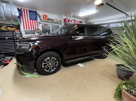

2021 black XLT that I've blacked the grill on.
When we bought it, we agreed we wanted some custom wheels when it needed tires. That time is now. We aren't going off-road. No lift. No big tires. I'm a not-cool mom and just want black. I found some on Tire Rack I like but I'm not savvy about sizing and offset and whatever. My wheels are 20" and apparent +44mm offset. The wheels I like are +18mm and Tire Rack gives me a warning that says:
"Aggressive fitment. May require suspsion(their typo. Not mine) lift and/or fender modifications for proper fitment."
From what I've read, it wouldn't make my wheels stick out that much, but I don't want them rubbing or something. Help a girl out. Would this significantly change anything other than how it looks?

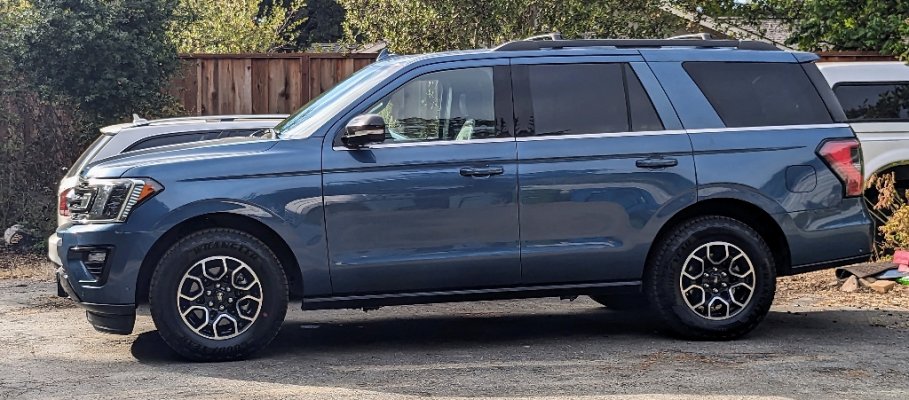

18" with the same offset (8.5Jx18 ET44) and tire size (275/65-18) as a XLT that came with 18s will be fine, exact same OD as the 20's or 22's. I swapped the 22's on my 2019 for 18's pulled off a late model F150.
my 18's...
one catch, F150s have slightly shorter rear stub axles than expeditions, I had to trim the stubs off mine to fit the center caps on the rear wheels

My 2024 Expedition XLT came with those exact same wheels. My neighbor has a ‘24 F-150 with the exact same wheels. I doubt Ford makes the same rim with different dimensions for two different vehicles. I mainly make this comment because I’d like the rims off of a 2020 XLT, that has the same offset as mine…44, but don’t want to cut the rear half shafts, but still don’t want to buy them and not fit. Are you saying the same offset should fit? Tire size should make no difference as far as the rear half shafts needing cut. IMG_8077.jpeg
