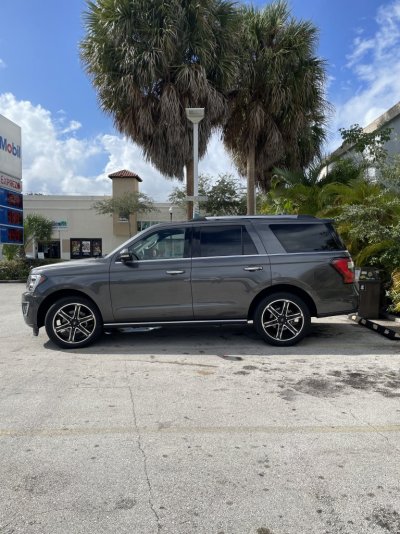

I have a 2021 Ford Expedition with factory ccd suspension, so I’ve heard lifting isn’t a good idea and I want to keep the suspension stock.
Questions:
  1. On my current wheels, what tires can I run to get more sidewall and aggressive tread without issues?
  2. If I go to a smaller wheel, what size works without messing up the ccd suspension?
Use is light off-road (sand, dirt roads, trails). Mostly looking for a tougher look and better traction.

The tires in your pic look like 2xx/45/22's or thereabouts, so you should be able go up to a 55 or 65 on the sidewall height without any issues, assuming the suspension is stock and hasn't been otherwise altered....and depending on how much clearance you actually have in the fender wells, you MIGHT be able to go up to a 70 or 75, but that might be pushing it....
