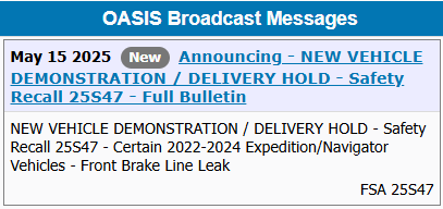

The above-linked information on Safety Recall 25S47 was communicated to dealerships today...
It is unfortunate that a photo of an uninvolved 2025 Expedition is being associated with this Field Service Action.
Good luck!
I did not notice the pictured Expedition in the article was a 2025 model (until I returned and reread the article) - I passed over the picture to read the text about the recall.
I did find it interesting that the media is able to report the safety recall before the Ford / Lincoln dealers are notified.

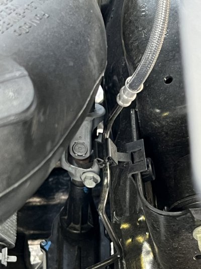

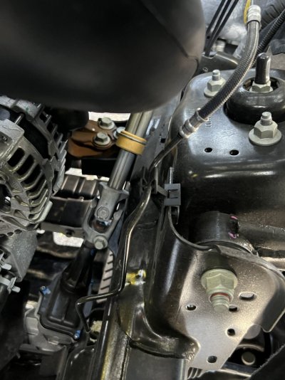

The recall notice states that clearance must exceed 10mm, and the brake line must be properly secured. I verified both using Mitutoyo calipers and confirmed that the brake line is retained with clamps. For reference, an average male index finger width is about 14mm—if you can pass a finger through it, the clearance is sufficient.
Thanks for the info and pic's!
