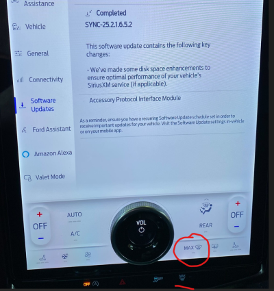

Anyone found a way to change or just remove the Max Def button on SYNC 4A screen? Maybe something in APIM "Climate Overlay".

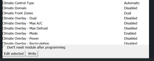

Check what you have in this location and change it so that MD is disabled and everything else stays as it is. If you do not get the desired result, just change it back.

Thanks for the reply. Looks like a "0" currently in that location, not connected to the car at the moment. Will try a "1" in that location just to verify no change on screen and than put it back.
7D0-02-01 0603 7A2A 0087

In that case, that button may be hard coded into the climate bar itself and cannot be removed. There are ways to add/remove the heated/cooled seats and heated steering wheel from the climate bar, but I don't see anything else related to the front defrost function in the APIM.
