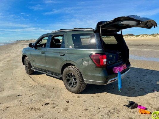

Thanks. Didn’t even know that tiresize.COM has that function. So it is sitting 1.06” further out. So why did you not keep using the stock Timberline wheel?
The wheels and tires came off my old Expedition. My 2019 was totaled in May of 2022. It was easier to swap out the tires myself versus a tire shop putting the tires on the stock wheels. I may put the stock wheels back on when I need to replace the tires.

I put 295/70/18 BFG KO2’s on mine this week. Everything stock, no rubbing.

I've been running 295/70/18 Recon Grapplers on stock Timberline wheels. Zero rubbing.

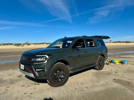

That looks nice. Have you towed anything since going w/those tires? An issues?
The trailer I tow is less than 3000 lbs and no issues - but after I put spacers on the wheels the front did rub and I trimmed and moved the front fender liners forward about an inch or inch and a half I also used my Dremel to trim the front lower urethane. No issues after that.
