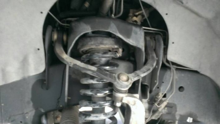

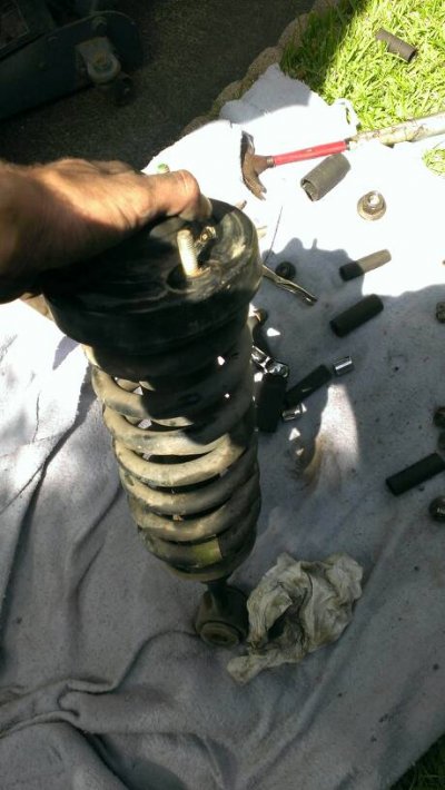

Just installed the front today with tallsville! Thanks a bunch, super nice guy. Took about 2 hours for the left front then 30-40 min for the right. Beginners learning curve. Talls helped me through the first and I did the second by myself.
I plan on installing the rear soon and getting some 285 or 305s :)
