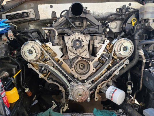

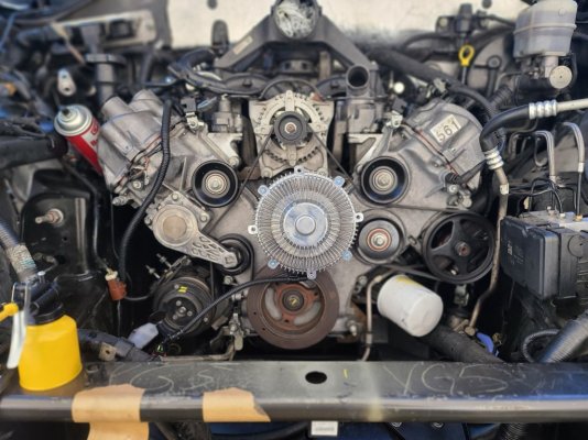

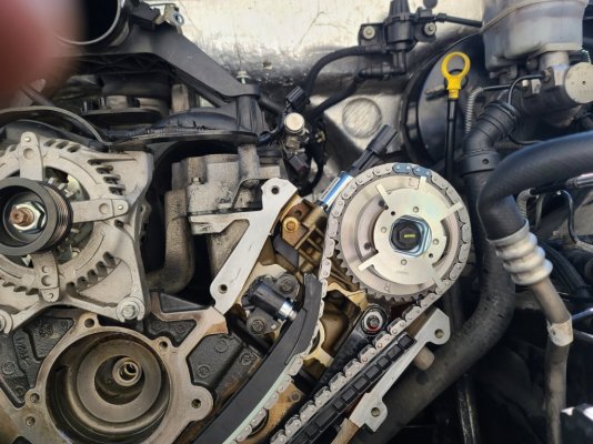

The start-up sound is coming from one or both chain tensioners. I had the same issue as well as the tic-tic-tic from a rocker/roller. My engine is a 2007, 5.4L 3v Lincoln Navigator. I replaced the timing components which included the tensioners and guides. While I was at it, I put in a new oil pump, front seal, water pump, thermostat, rocker/rollers, valve lifters, VCT solenoids, fan clutch, and alternator. I did the work myself over a two-and-a-half-month period. All total the work cost roughly $2200.00. This included the specialty tools and other related stuff that made the work go easily.
