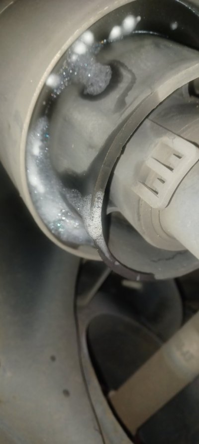

Looks like we have a leaky air spring. see pic. Ordering a pair of replacement air springs today. Hopefully I'll receive them before the old ones completely fail. I was looking for a DIY video for replacing the air springs (not swapping for coil springs) but only found Gen 2 so far. Anybody have a link to Gen 3 videos?

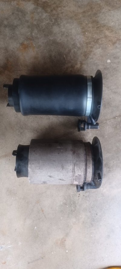

Well, good news is, I was able to remove one of the rear shocks / air spring assembly and disassemble it.
Bad news is, the Unity Automotive brand replacement air springs I received from Parts Geek were wrong / defective as in didn't have to outer metal sleeve on the air spring, air spring was too long, all the o-rings were the wrong size and/or diameter, the solenoid was very loose in the air spring housing, etc., etc. Also, the air bag material felt thin / flimsy.

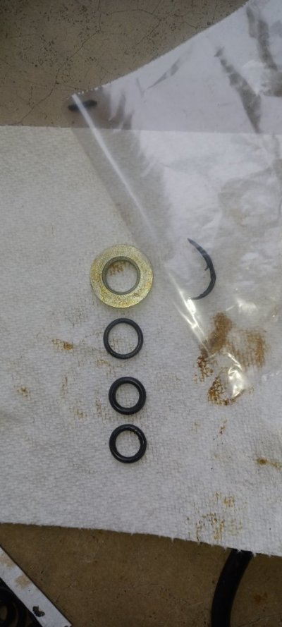

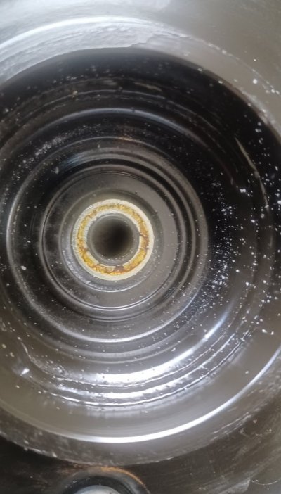

I have an urgent question:
Q: What kind of o-ring seals the shock / strut rod to the top cap assembly and where does it go (above or below the washer under the cap)?
I don't see an o-ring groove in the rod, only a raised "bump" on the rod near the top and a chamfered area inside the top cap opening.
When I disasembled the air sping, there was a piece of torn o-ring in the area of the washer under the top cap and what looks like an o-ring stuck / welded to the washer.
We only have 1 car (this Navigator) at present, so I re-assembled the air spring " to get me by" but now it's leakng air like crazy and I think the leak point is the rod to top cap area.
I can't find any illustrations showing the o-ring or it's location in relation to the rod, washer and top cap assembly. Any leads / ideas / videos would be greatly appreciated.
The 1st pic shows the washer with the o-ring stuck to it as I re-installed it.
The 2nd pic shows the washer with the existing o-ring removed (first one down) and the next 2 lower o-rings are ones I might use. Note the impression on the washer from where the o-ring used to be and the bit of loose 0-ring I found when I fisrt dissasembled it.
The 3rd pic shows the top cap with the washer and o-ring removed. Note the chamfered area around the opening. I think this chamfer holds the o-ring in place.

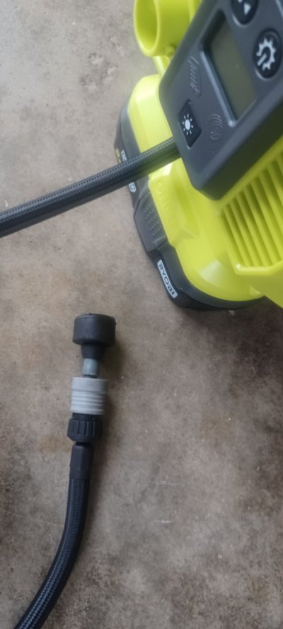

Q: how can the air spring solenoid valve be opened to allow air into the air spring while it's out of the car?
I'd really like to test the assembly for air leaks before I re-install it in the car.
Update: I was able to inflate it off the car by removing the solenoid and inserting a rubber bung with a tapered nozzle in the solenoid hole attached to a 18v Ryobi inflator.
I found the same thing earlier today. The remaining OEM assembly has been slow-leaking for a while, but it has gotten a lot worse in the last couple days.
It's a little late for your situation, but here are the Arnott instructions for reassembly. Pages 8-9 show o-ring positions.

Hope your replacement air springs work out better than mine did. I bought another cheaper brand air springs and they were totally wrong. That's why I had to re-install the old stock air springs until I received the Arnott coil spring units.

OK, I just wanted to post and close the loop. After the 3rd attempt, I got mine to work right. The Left side worked the first time. The Right side kept tearing the tiny o-rings on the shock rod. What I couldn't see in the detail drawing was the o-ring needs to seat well inside the washer's inner chamfer, so that it doesnt' tear. I had torn up all the replacement o-rings, so I was able to find one from a HF miscellaneous kit I purchased a while that did the job.
