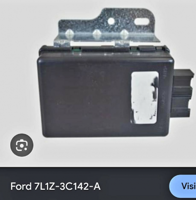

Thanks Johns-exp, but I've been under the vehicle and it definitely is air suspension all the way. I'm turning my attention now to the (7l1z-3c142-a) electronic suspension control module, found in 2007-2013 Expeditions and Navigators, located under driver's side dash behind and upwards from the parking brake pedal.
Here's a picture of it:
It's the 'brains' of the air suspension system that tells it when to turn on the compressor, when to vent, make adjustments as you drive, how much to go up or down depending on ride-height sensors, etc.
I'm going to check a couple of more things, and then I'll probably swap one in to see if it makes a difference.
