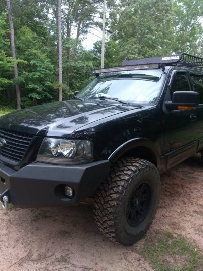

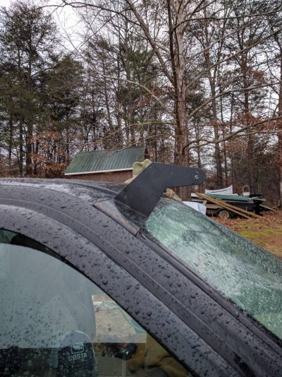

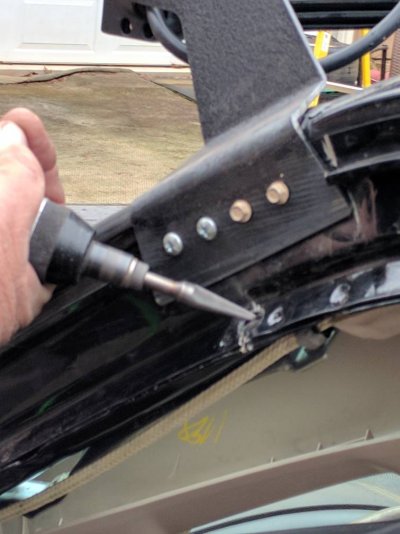

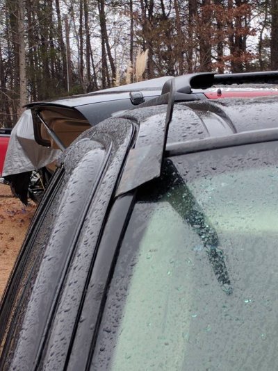

At the time when I was looking for door jam mounts nobody offered them and that was about 2 years ago. So I bought some off eBay for a 04 f-150 and had to do alot of twisting and bending and cut a lot off and now they work great.
The screw's in the picture was temp only to hold the mounts in place to test fit the 52" light bar.
Once I was done fabing them I took the 4 screw's out and replaced them with 2" long machine screw's so that they go all the way through the A pillar and use lock washers and nuts to permanently mounted.
It's been 2 years and no leaksa39c164a4749015b52ecf1863647c7fa.jpgb5a4b17ba13acf5c0f7a3f2f592d9904.jpg8cb43b5b3026f2972e276f4efd47bf3f.jpgeb0fe214dd9defb3fe63d5d505da8f9a.jpg
