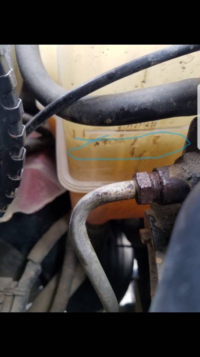

Need help/advice on why this is happening. 98 5.4 when its running the coolant level drops significantly. But then as soon as I shut it off the coolant level rises back up to normal. What could be causing this? Have a 500 mile trip planned this weekend so I need to figure this out.

I took some pictures the best I could.316b5bcff7e089da9c7c04f9ed63c20c.jpg0f9aa6b6ebac7efa288b7dfcb4b6525b.jpgbee163b309aa7605932ff4e0fac76810.jpg

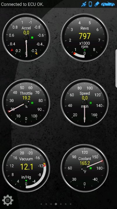

Temp rn

Is 165 as warm as the engine gets? That's about 30 degrees too cool.
The thermostat opens at 190 or so. For some reason the first time I run the engine after draining the coolant (replacing thermostat, radiator or intake manifold) the engine will go up to about 215-220 before opening the thermostat. Then it cycles between 190-205 just like it should.

No, it gets up to 190 195
