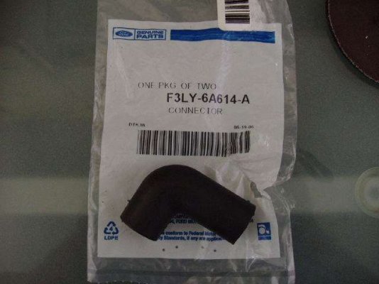

Laying underneath the passenger firewall area. Look on the firewall up above the oxygen sensor. You'll see a black plastic cover (shield) attached to the firewall. The AC drain is behind that little plastic cover. High pressure under the hood when the Expy is going down the highway can cause AC drain water to backflow around the drain outlet back into the carpet and passenger floor insulation. The fix for that was to install the rubber elbow Ford came out with for the Expy and F-150. You can pop that black plastic shield off with a long screwdriver. It's just attached to the firewall with some plastic rivets.
Ford's elbow fix for the AC drain ...
Drain elbow installed on AC drain outlet.....
