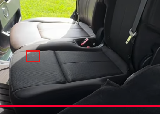

Actually, after watching the vid, that may have been my truck. I feel like I can remember this spot/stain that I could never quite get out of it.
