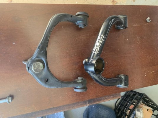

I decided on BDS Upper Control Arms. I picked them up from the local 4wd shop yesterday.
They seem to be a well built piece. I’ll post up some pictures later and hope to get them installed next week.

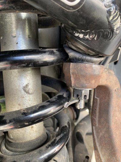

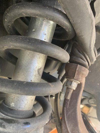

So we have a new problem and BDS aren’t compatible with the Bilstein set up.
So with the Bilstein and factory UCAs the inside of the control arm hits the top coil at full droop. The knuckle and ball joint are close but do not make contact. No binding or anything just an annoying clunk at full articulation.

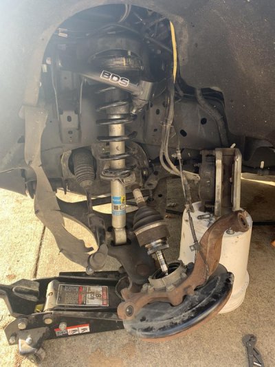

On to the BDS arms. They are a very well built piece and make the factory arms feel like folded coat hangers.
Unfortunately the new angle of the ball joint cup pushes the top of the knuckle down and over so the top of the knuckle is actually inside the coil at full droop. Giving me an absolutely unusable setup.
And to make things even better the UCA bolts hit the top coil when trying to remove them so the whole coilover has to be dropped out to get the bolts free.
I actually broke out the install instructions to make sure I did not screw anything up.
And it says the arms are designed for Fox 2.0s and will only work with some spacer kits.
