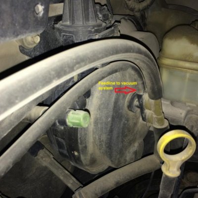

OK! FIXED!
The thin vacuum line as described by everyone was good, leaving me scratching my head. So I started to follow each line on the system. The culprit....... the main hose coming from the brake booster creating the vacuum in the system. This was completely severed at the tie-in valve in-line behind the electrical wiring on the firewall.
