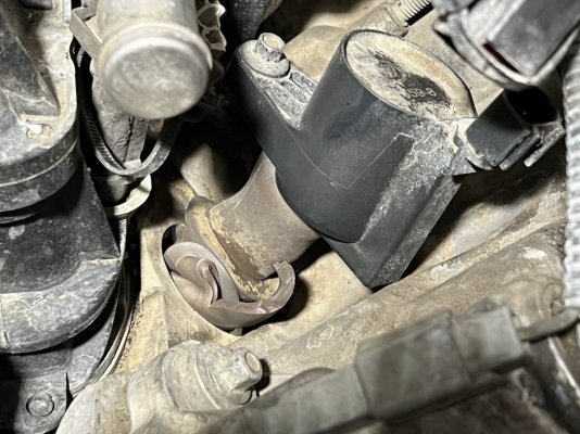

So, found the time to dive into this on Sunday.

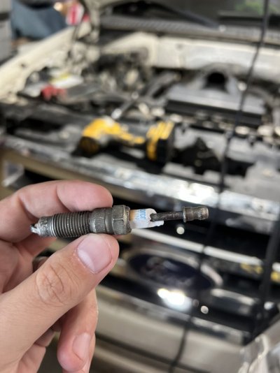

This is what I found on cylinder 5:
Looks like damaged threads and a plug blowout.
I’ve been throwing codes for a cylinder 3 misfire, so I decided to change all the plugs (NGK platinum), new boots and springs, and I swapped in a junkyard coil (ACDelco branded) to #3

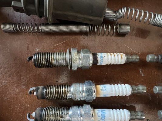

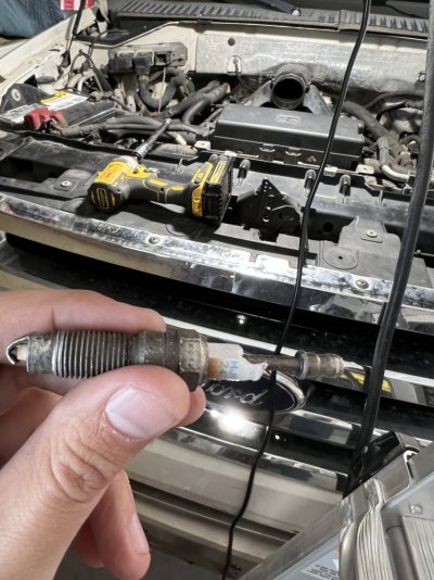

I found something interesting in cylinder 4 too… here’s all the plugs in order:
One of these is not like the others…

Who did the last plug change on it ? What's the part number on that odd plug ? The 2008 5.4 uses two possible style sparkplugs. A Motorcraft SP509 style plug. Or a SP546 style plug. Original coils with either black, or brown boots. Brown boots would have the full thread plugs, black boots would have the half threaded plugs. But I know, over the life of the truck coils may be replaced with another coil / boot combo.... So you just have to look.
Can you use a borescope and look into the sparkplug wells and see if possibly the wrong style plug was used ? That odd plug doesn't even have the right seat on it.... Geez ....
2008 Expedition Sparkplugs at Rock Auto
Motorcraft SP509 plug ... brown coil boots from the factory...
Motorcraft SP546 Style plug .... black coil boots from the factory...

I'm brown boots, full thread. I'm going to blame the prior owner for whatever that was....
Complete set of plugs installed with new boots/springs. Added 3mpg to my average (11.6 to 14.7). Cured the #3 misfire, although I still have codes for cam/crank correlation.

I would borescope both those cylinders just to be sure what happened here. Especially #5 with the crimped electrode. Very odd indeed. Best case, maybe the plug was bad from the get go and water got inside the insulator and boiled out, or worse case something bounced into the cylinder and smashed the electrode.
