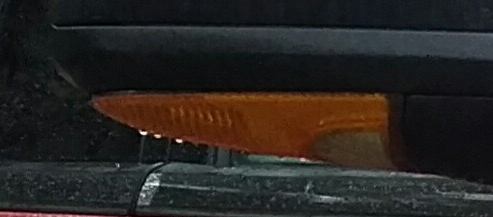

Okay, so, I'm just more curious about this than anything- How come my paint is really bright red on the front fenders and the hood, yet everywhere else it's more of a muted red? Is that just something that happens?
Also, my passenger side mirror blinker thingy (on the underside) is loose and hanging down a little, is there a certain way to fix that or can I just slap a piece of tape on there and call it a day? (sorry for the terrible pictures, I never thought to snap one of the mirror itself, I can get one later)

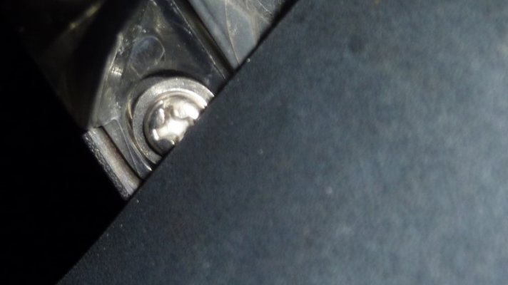

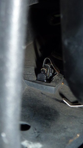

As far as the courtesy lights on the exterior mirrors go. Check the spring clip is in place that sticks up through the bottom of the mirror body. That's what holds that end of the lens up tight. Also check the retaining screw at the inner edge of the lens, on the bottom of the mirror body. Push the mirror body full forward (as far forward as it will go...) and look up under the mirror body and you'll see the retaining screw up there. Just make sure it's secure. You can get replacement lenses on ebay. I replaced mine with clear ones and use amber and clear LED bulbs.
Here's the spring clip behind the mirror glass that helps secure the lens to the mirror body..... push the mirror glass to gain access to it...
Here's the retaining screw at the inner edge of the lens .... push the mirror body full forward to gain access to it....

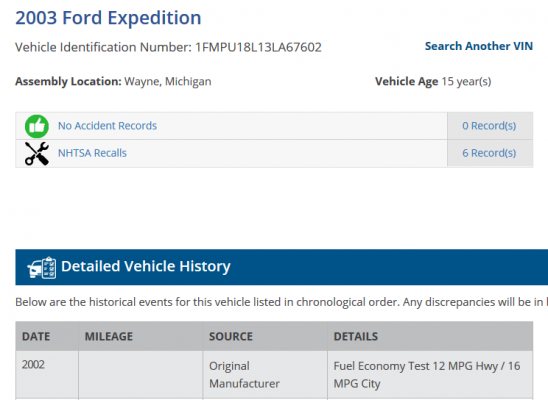

No wrecks, guys! I checked that site, and boy, the 16 mpg it was tested for originally would sure be nice because I'm running at 7 for now.

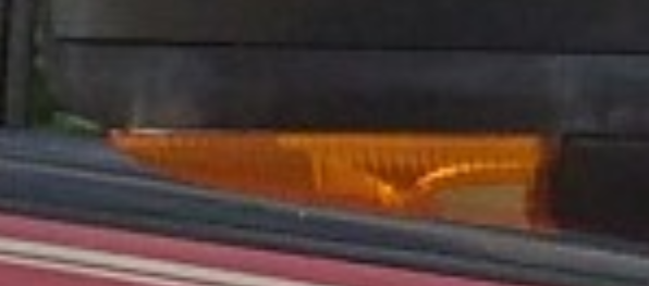

Oh, and I couldn't find a screw under the mirror, but behind it, I could see the clip and it was like, rusted and not even doing anything, I tried to bend it to somewhat help with a screwdriver but it didn't work...

Well if you fold the mirror forward as far as it will go (through the normal stop detent...) and look up from underneath, you should see the retaining screw up there. If it's missing, find a replacement screw (stainless...). If you buy a new lens it comes with a new spring clip on it anyway.

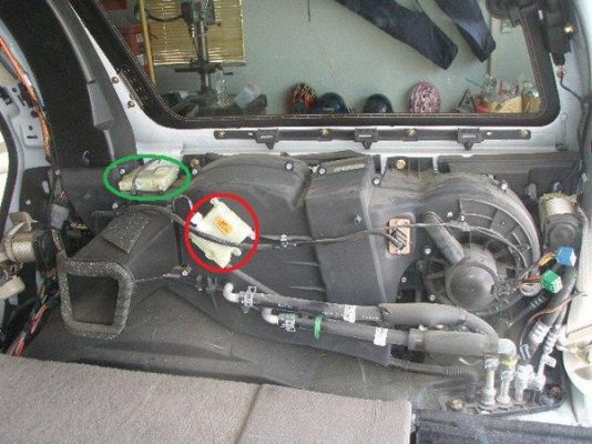

What's wrong with the rear A/C ? Is it the typical actuator box failures ?

Hmm, is that what the AC looks like inside? How hard is it to remove all of the trim to look at it? I might do that myself, because if I do, and those boxes are the problem, they look easy enough to replace....

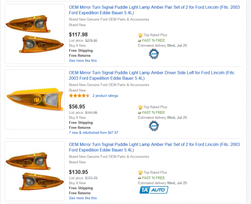

Oh, you mean push it PAST the point where it stops? I don't think I did that, I was worried I'd break it... I'd buy new lenses but amazon doesn't have them and ebay wants way too much money for them! D:

You need a good set of tools. But here's a how to video on replacing the rear blend door actuators, if that is your problem. You didn't say what the rear AC was doing, or not doing.

The rear AC however, does not. It doesn't blow hot air, it's just simply not cold, like a fan you'd sit on your desk, it just blows the air. Also, there is a constant hissing from the rear when the AC is on, and it increases and decreases with what I assume is the fluctuations of the AC system.
It just confuses me, because... if it was a leak, a leak bad enough to hear the hissing, surely it would've leaked enough to stop my front AC from working, right? I read somewhere else on the forum (perhaps it was you, moose...) that if you're a bit low, the rear will stop working first, and all you need to do is add refridgerant to get it working again.
