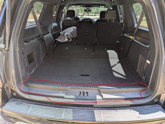

In Step 1 of the instructions they say to remove the "load floor storage compartment" and then refer to a service manual I couldn't find. What they mean is to remove the storage area under the flap where your jack and other items are stored. To do this you have to remove the rear-floor plastic trim, circled in red here:
That trim piece just snaps off if you pull up on it from the back edge (the edge towards the front of the car).
After you pull up the trim, you then full open the back storage area, empty it out (if it isn't already), and use a 10mm socket to remove the two bolts circled in red in the upper right and left corners here:
After you remove those two bolts (and have already removed the trim as described above) the whole plastic storage area just lifts out, you have to kind of tug on it to get it to release, but it pops right out.
The two gap fillers are attached to this storage bin, and to replace them you pull it out and work on it separately.

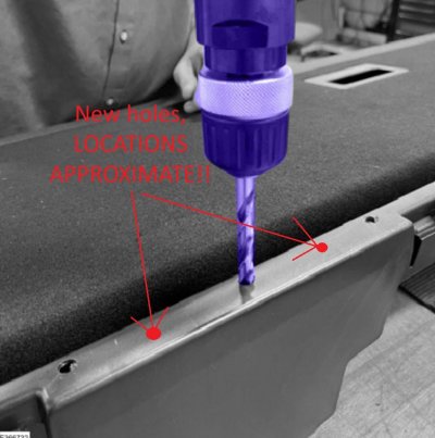

This step is not documented, but not that hard to do. The replacement gap filler had 3-4 more posts than the original, I assume for extra holding power, so while most of the posts had holes to go into 3-4 of them were just hitting solid material. I used my 11/32" bit to drill new holes where the extra posts were located. Note that I did this by eyeball, because the way the posts are held into place is that when you push the mounting posts of the gap filler through the holes, you then push a serrated, internally toothed lock washer down over the plastic post from the other side, which bites into the post and then won't slip off, holding the frame of the bin in between. This means that the holes don't have to be perfectly aligned or shaped as long as the larger circumference of the outside of the washer has something to press against.
The image below is from the TSB showing how you drill out any remaining plastic from the original mounting holes. I've then added crudely spaced red circles indicating that you'll just have to make some more holes - NOTE THAT THESE CRUDELY MARKED RED HOLES ARE NOT CORRECTLY PLACED NOR THE CORRECT NUMBER, THEY ARE JUST SHOWING THE PRINCIPLE OF THE THING:
