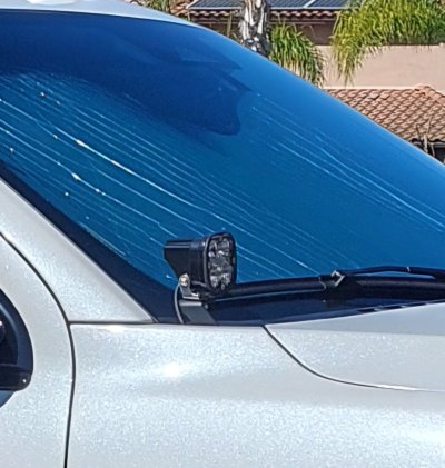

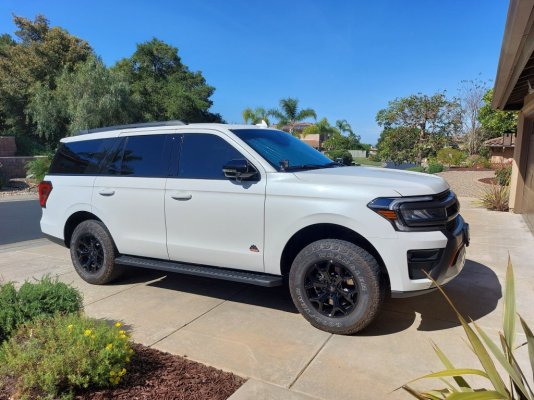

Coming from an F150 Tremor that had added a few off-road lights to a 2024 Timberline I had to find some creative solutions to repeat the exercise. Finally getting around to executing….
First, I hate running cables though the firewall, enter the M&R wireless light controller. Solid build and the actual connection box fits perfectly on top of the fuse box under the hood with a little industrial Velcro. Step 2 was the easier addition for ditch lights. BD squadron sports using Amazon brackets for F150. Where the windshield seal for the wipers moved easily on the Tremor, the Timberline required some manipulation. With a little shuffling everything worked out great. Pics show the end result.

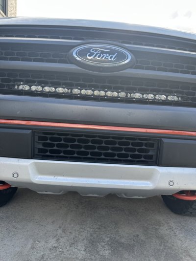

I added a Baja designs light bar behind the front grille. It works well and isn’t too showy, though people seem to think I’m a disguised cop often.

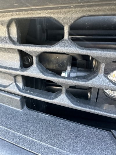

Adding a few more pics. The lights have three states, off, amber (as above) and bright white LED. You can see the bracket fabricated for these to fit.
