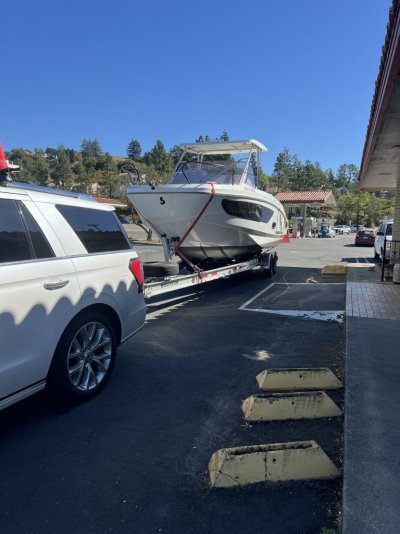

This boat is 28ft on an Aluminum Karavan Trailer 1800lbs boat empty tanks with trailer is right around 9000lbs. The Expedition is heavy tow pack which includes the HD 3.73 gear set in addition to additional cooling capacity. 700 mile tow Seattle to Ca I would not recommend towing over 6000lbs with the standard non HD Expedition.
Now if all your doing is yard dolly moving thats not really towing its just shuttling around a dry yard etc.
A 34ft boat running twin mercs is going to be in the 10,000+ lbs way past the standard light duty expedition which is basically mini van SUV format etc.
The HD F150 setup is like the HD expedition both are running gear sets shared by trucks with far higher payload and tow ratings. There could be axle differences also.
