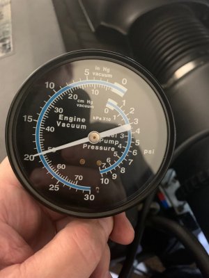

Get a vacuum gauge to make sure you have proper vacuum (if not already performed). Will cause a soft pedal if leaking. Did new booster have a new check valve in it?
