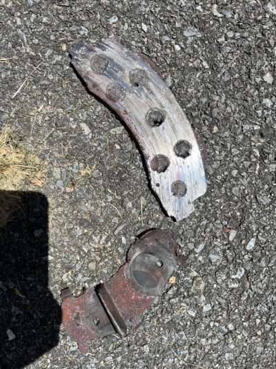

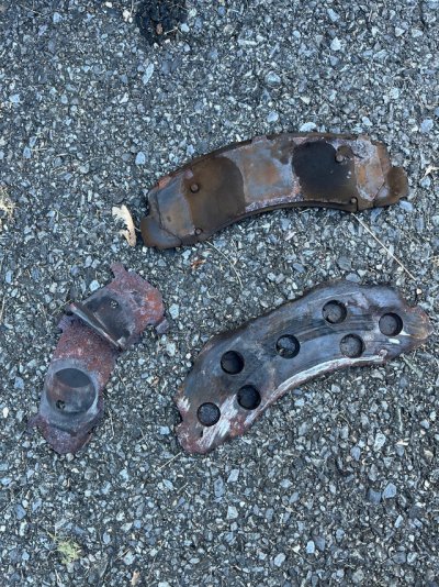

So I finally got around to this project. Checked the parking brake and all seems ok there. Nothing broken or crumbling. I checked the front passenger brakes and those had about 50% pad life left so I was a little confused as to the squealing, etc. until I pulled the sticking wheel. That front driver caliper had one working piston and one that completely failed. The result was the brake pads being compressed at a bit of an angle and getting stuck that way. The pads got completely obliterated and some pieces were actually MIA. The brake hardware was falling out as I removed the caliper as well. This explains why I went from no noticeable brake problems to a squeal and then a catastrophic failure a few days later. Replaced the front pads/rotors and front driver caliper. Drained and filled the brake fluid. Did not do the hoses as of yet as this was about all my back could take.
