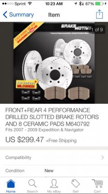

nauti1
Aug 1, 2014
15
The best brakes I ever put on my expedition.
I had these on my 99 Eddie Bauer and now they are on my 07 el limited. No more warped rotors on either and the ceramic pads don't dust up the wheels.
