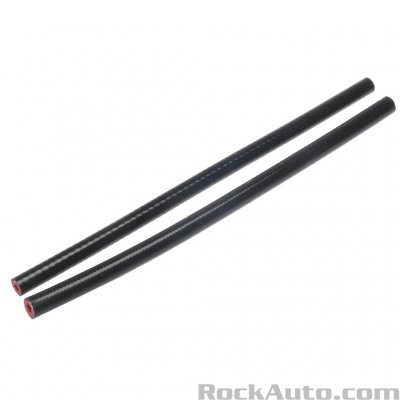

Those are your EGR differential pressure sensor feedback hoses. They plug into the bottom of the DPFE sensor right there on the side of the throttlebody in your picture. Be sure to replace them with actual high heat DPFE hoses, NOT fuel line. They sell them at any AutoZone store or you can find them online.
DPFE Hoses at AutoZone
DPFE Sensor ....
DPFE ( High Heat...) Hoses ....
