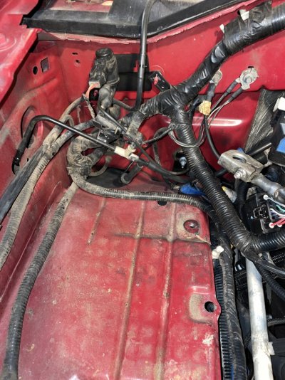

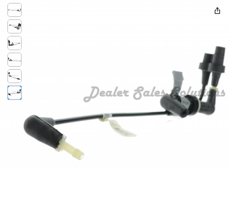

Here's a photo I took during my multi-phase project last year. 2006 Expedition XLT with 4WD. The battery and vacuum reservoir are removed. Source vacuum line enters from the right side. Following the 1/4" source black line from right to left: first black vacuum tee is for HVAC, 2nd tee is for the 4WD IWE. The open vacuum line on the left side of the picture goes to the vacuum reservoir. The IWE vacuum lines and check valve are available as an assembly--check this part no. 4L3Z-3A788-AA. IMO good to replace, especially if only for the check valve.
Thank you for all that, I’m starting to understand it better. Bear with me as I’m new to these vacuum lines. They seem to be everywhere. But on the solenoid where it has 2 hose outputs. The part number you gave is for the bottom port correct? My top port has a partial hose connected, it comes out of the top port and about 8” down it’s broken and the rest is gone. Where does that line go to?
One more question lol the part number you gave says it’s for a f150 and when I put it in Amazon or AutoZone etc it says it’s not compatible with my 04 explorer Eddie Bauer. I’m guessing it works for both since you suggested it but I just want to be sure before I order it. Thank you again for all your help, it really is appreciated.

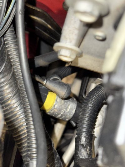

It's hard to see, just took that picture. The rubber elbow next to the low pressure a/c sensor is on the actuation line coming from the solenoid. You're looking for a vacuum line that's wrapped with black flexible conduit, probably has fallen down behind the valve cover/engine; the connection is a rubber union, sort of. There's also a semi-rigid plastic vacuum line coming out of the conduit that goes to the left front. Go ahead and get the assy I mentioned previously.

You probably won't find the IWE vacuum line assembly listed under Expedition. I looked, and looked... It fits my '06 just fine. Something to keep in mind, when in 2H and engine on, vacuum is being applied to the IWE's via the line coming from the solenoid. That's going to give you a mild vacuum leak...fuel trims are probably elevated, if you want to check with a scanner. And since it's on the same vacuum circuit as HVAC, you may see anomalies.

As SafariGoneWrong noted this is the part number I used on my 2004 as well 4L3Z-3A788-AA. I think the lengths may be slightly different for the Expedition and F-150, but it'll fit just fine.

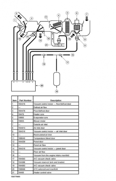

Here's a diagram of the IWE vacuum lines that should help a bit. You'll notice 2 lines that are loose, they are vents. I mention the vents because I think the 2nd pic you posted is a vent line and is intended to connect to nothing. They have freaked out almost all of us until we figure this out.

Here is the vacuum line layout for the 2004. Not sure how close it is to the '03, but hopefully it's close.
