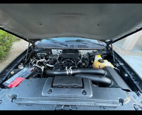

I have a new 2023 SPP HO and live over a mile high where the air is thinner. Most of its miles will be well above sea level. While the OEM airflow seems decent on all out pedal to the metal acceleration, I am wondering about the benefits of increased air flow at higher altitude for the performance Raptor engine. Anyone have any experience with this? I was thinking the Ares CAI (image below) since it is simple and lower cost. Any suggestions?
