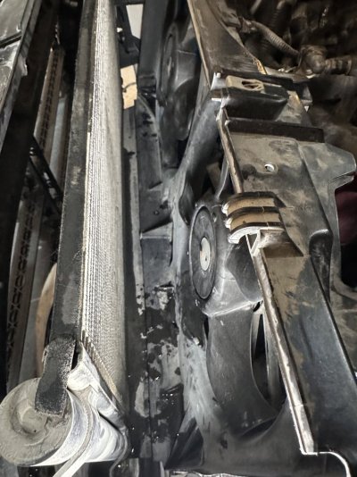

The differences between the two systems are mainly the radiator cooling fans (brush vs. brushless), radiator size, and the radiator air deflectors.

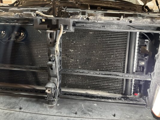

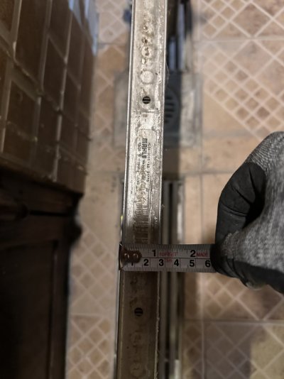

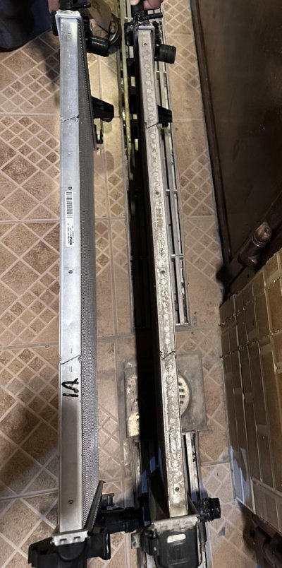

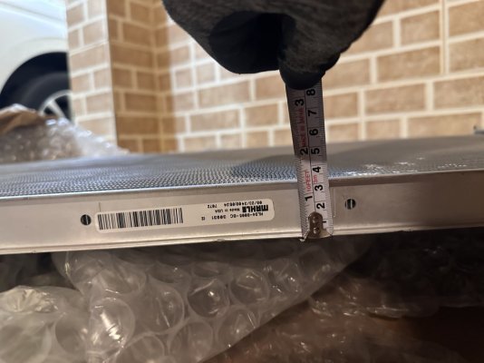

My vehicle has the Standard-Duty cooling system. I bought the heavy-duty radiator and I tried to install it myself. The thickness of the standard duty and heavy duty radiators are 2.6 mm, 3.2 mm, respectively.

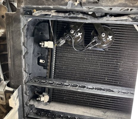

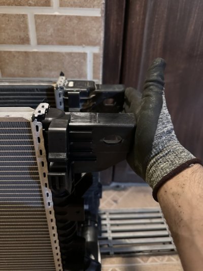

As in the attached pictures, the radiator fits exactly and it is almost a replace-in-kind job. However, the air deflector were a little bit short on the vehicle’s driver side. The reason being that the heavy duty radiator has a shorter plastic cover as compared to the standard dury radiator.
Also, I dismantled the front bumper and grill to gain access to the air deflector clips. Those were very hard to pull out even with the vehicle’s front end removed! I replaced them with a zip tie to save myself headache for my next radiator replacement job.
Upon replacing the radiator, I notice the car normally operates at 185 degF when the ambient temperature is 117 degF. never exceeds 194 degF in Summer at highway speeds while going uphill!
