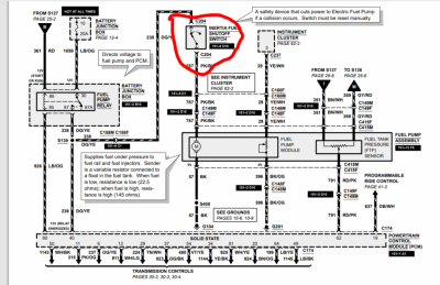

Maybe check a few voltages before you drop the tank.
I think the power from the relay is only on a few seconds after you turn the key if the engine isn't running, so you might need a helper.
Also you can check the inertia cutoff and reset it if it has tripped. I think its on the passenger side by the kick panel on the right.
