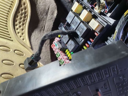

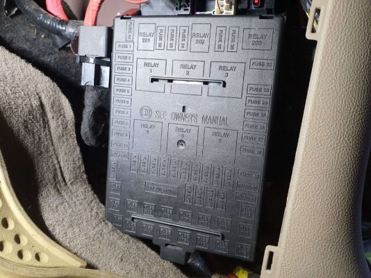

No, these fuel pumps are not subject to failing like that. Check the PCM relay in the fuse box there at the passenger kick panel. ( Top right relay is the PCM relay ....) . Look for melted plastic on the socket and around the terminals of the relay. That indicates severe heat between the PCM relay and the fuel pump relay. If you find heat damage you can swap the PCM relay with one of the other two up there just to test the circuit and see if you get the fuel pump to come alive. In the end you have to either replace the fuse box, or if you want to deal with the soldering, replace the fuel pump relay itself. The fuse boxes are very year model and date of production unique. You can't just go to a salvage yard and grab one just because it looks the same.
IF you want to attempt the external relay installation trick, these are the relay connection points for the standard 5 pin relay for the fuel pump in the middle of the fuse box circuit board.
