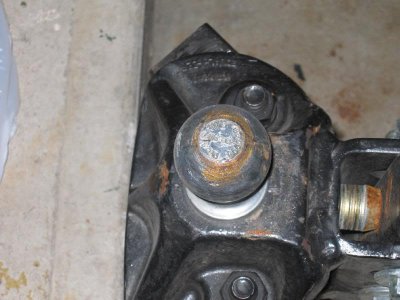

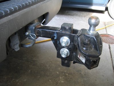

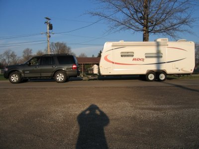

Dave --
I strongly suspect your Equalizer hitch is not set right. By definition if the rear is sagging you're not transferring enough weight from the rear axle. Both axles should compress equally. Likely your front isn't compressing at all since you mentioned squirrelly handling in the other message -- typically the result from weight being removed from the front (steering) axle.
Ford trailer receivers (on the bumper) are pretty sloppy any you will need several washers in the Equalizer hitch head to get the angle correct.

I have an equalizer as well. I have the maximum amount of washers installed to tilt the head , seven is the max allowed. I too have more sag than I like. I posted yesterday for anyone that may have experience with SumoSprings installed in the coils, this is really the only option that I have seen.
One response was a lift kit as well. I am considering doing both as I cannot do anymore adjusting with my equalizer. The TT tows steady and true and I dont get blown around, I would jusyt like to sit more level when hitched up.

Make sure the hitch head is high enough as shown in one of my photos above. This setting handles a 700+ pound (on occasion) tongue weight.
I have the 10,000 pound Equalizer. The smaller version may not provide enough weight transfer.

Chuck, I think I'll play with the setting some more since I think you could be right but when I did talk to the Equalizer support guys, they said that sag was "ok" as long as the front axle wasn't too high or too low of the allowable margin. My last adjustment I have 6 washers and I went up one hole in height. I think I'll add the last washer and maybe go up another hole on the head.
Getting these things tuned in is a pain in the rear if you ask me. If I had the same load every trip it would be easy, but every trip I take has more or less weight in the vehicle and it throws it all off.

Dave --
View attachment 26075 View attachment 26076
Chuck, how many washers are you using in your setup in these pics? I'm definitely going to raise my ball hitch and right now I have 7 washers and just now moved up the ball the same height I see as you. I don't know my tounge weight, so I'm not sure how it's going to change the dynamics. I'm sure I'll have to play around a bit with it. I have the same 10,000 pound system.
