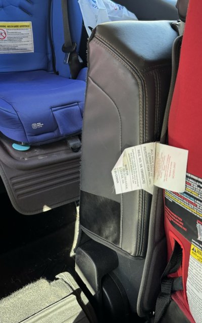

Here is some photos of what mine look like. Not extremely pretty but functional and don't really notice it unless you fold just the middle seat down.

pessimisdick
Jan 30, 2024
wa
Mine looks similar now. I bought the same stuff. It’s definitely darker so it’s not perfect BUT it’s very functional and should keep goldfish out just fine.IMG_0554.jpeg
