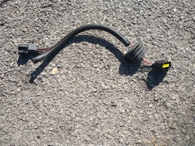

What do you mean by this: "You don't put whole new wire in you just splice the new plug in."
What do I need to splice in going by the picture.
I put the old maf in and it did the same thing, wouldn't stay running or idle. So it probably the wiring
I unhooked the maf and the car runs but it still has the symptoms before, rough idle in the highest gear. So I'm thinking maybe it's not the maf causing it to run rough in high gear
The plug was bad on mine. do you have multimeter? there is plenty of YouTube videos of how to check the MAF sensor on 5.4 2v tritons.
But your symptoms mirror mine when my plug was bad. I just spliced in the plug that plugged into the MAF sensor.

What do you mean by "I just spliced in the plug that plugged into the MAF sensor"
the yellow end has 6 holes. the other end there is a red plastic thing in the middle and 2 screw like things on top. I don't see anything to splice
Look at the picture i posted

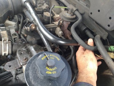

Are you sure you reconnected all the breather hoses back to the air filter. On my daughters Ford Edge, there was an engine vent house from the rear engine bank that I forgot to connect back into the air filter and it caused exactly the issues you describe.. as both sensors are doing the same thing, it sounds like your issue might not be due to the MAF sensor, so just throwing out other ideas.

I’d second this. There are some breather on the air inlet hose and maybe you’re getting a vacuum leak tripping a MAF code. Worth a look.

You guys were right. After I took off the air filter hose all the way to the throttle body, I forgot to connect a hose. See the hose in the picture.
I bought a new maf and it runs ok.

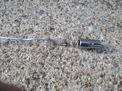

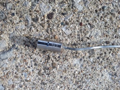

I did a scan and it said my #7 spark plug is misfiring. the nut that holds the #7 coil is murder to get to. 1st I used 7mm connected to a socket, but not enough room to unscrew it all the way. So I made the wire inside the socket thing lol. Might help someone. I think after I put a new coil and spark plug in it will run fine...I hope. Thanks
